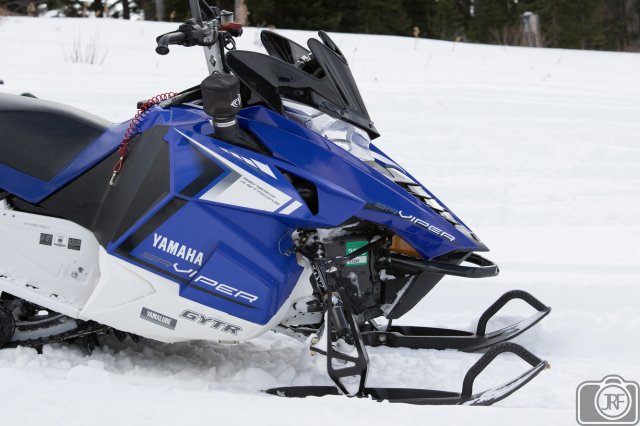

Has anyone tried to fit the ac hood pod on a viper....be a good look for a turbo instead of the stack out of the hood

We considered the same thing when installing our MPI turbos However underneath the hood With the Yamaha Motor in this chassis is jam-packed. So even if you had the AC air intake louvers up top You still couldn't get the air plenum up to that area. We finally settled on coming out the side but we changed how MPI does it so our air cleaner stands straight up and is tucked in closer to the windshield so its not as noticeable and looks more like its suppose to be there.

Cool! I like where EVO puts mine as it looks more natural to me. Is rather noisy there though.......

I like that. Got any pics of it with the side panel off. I want to get mine out from under the hood.

Your MPI kit should have came with the longer aluminum tube for coming out the hood. They ship with the parts to do it both ways. I painted the tube black
stingray719
What I liked about the EVO one is the tube out of the hood is silicone so it does not damage when rolled over.

I wish Hurricane would pipe there intake like this, instead of cutting the hood........
