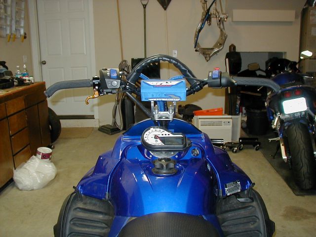

Kinda like this??

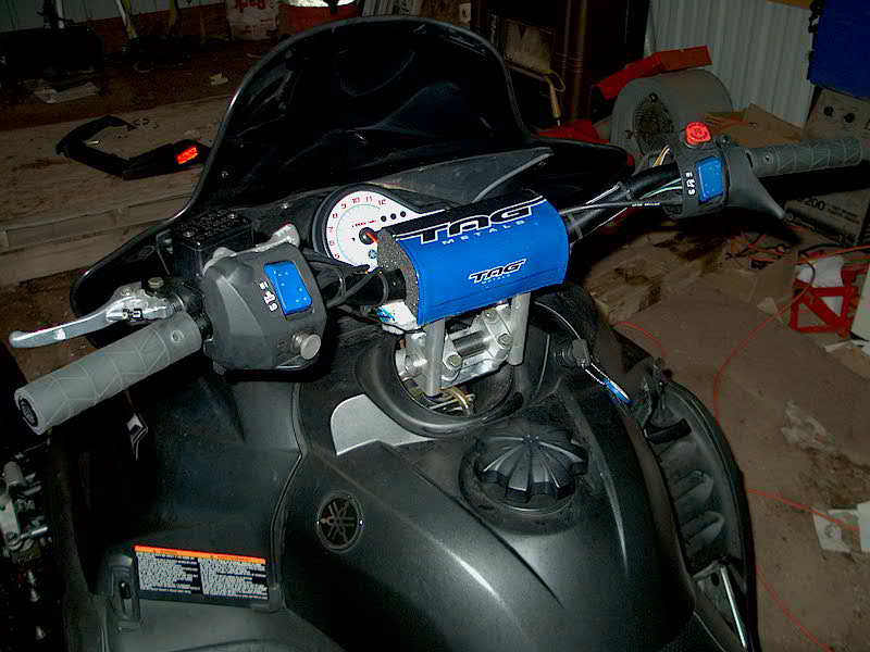

Kinda, I would like to keep the windshield. Last year 3" height and rotated forward worked well with the stock 05 shorty seat height for my daughter. I would like to raise the seat 4" for myself. Is it possible to keep the windshield if you reroute the steering column forward?
I have a set of Alum. dirt bike bars with a YZF450 bend, on 5" Mountain Machine Piviting risers, can put them anywhere you want without the huge cost of the articulators.
[/img]
Only problem with going that way is you over-center your steering and it gets kinda weird feeling and you still can't see your gauges. You can do rider forward for about oh................$2 in steel and a couple hours of time! Not sure I would do it for my daughter though!

My setup looks high, but remember the stock bars are like ape hangers. With the 5" risers, and the 450 bars, it is only about 2" higher, but it allowed me to mover the bars where I needed them.
I am by no means tall (5'10") and I can see the gauges sitting down.

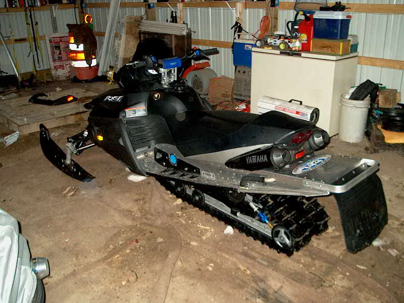

Stock 05 seat, which was the thickest of the RX sleds
