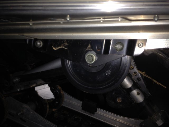

Here are a few pics. The rear mount uses a custom drop bracket that bolts to the existing drop bracket. The brackets are 1/8" thick and beings they mount on the inside of the factory brackets 1/8" must be trimmed off each end of the aluminum cross shaft.
The front mount is a triangle bracket that mounts on the outside and matches up with 2 existing holes in the tunnel for the mono mount. The front most mount of the triangle bracket is the new hole for the 144 skid. The triangle bolts in place and then serves as a guide to drill the new through hole in tunnel. This hole still catches the steel mono plate so its reinforced and solid mount hole.
When the skid is installed it is mounted at same position in tunnel as the factory apex xtx sleds. I got all my dimensions from an apex xtx when I designed my plates. I have them drawn in autocad and can get some laser cut and powder coated.
The finished plates would have rounded corners and look cleaner. Photos are of my prototype mounts that we tested all season on the sled.

The rear mounts for the Attak are different then your ltx Vector right? I know I have a solid shaft across for the upper wheels and the LTX has wheels mounted independently on each side. These years use different brackets ? so your's won't work on my Attak?
The drop brackets are actually the same for all 136 mono I and Mono II suspensions.. I even double checked part numbers again just to be sure. Below is a list of models my mounts would work on.
06-07 Attak
08-10 Apex LTX
06-07 Rage
08-15 Vector LTX
