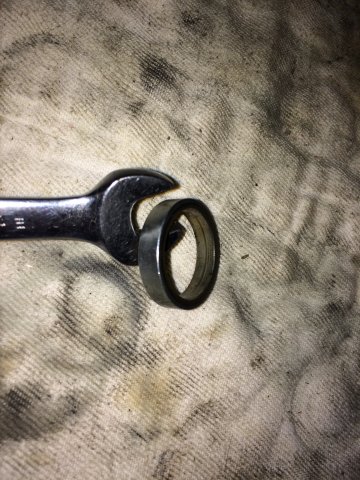

Put the chain case back together and got an extra washer. Any ideas on where it goes? 12 mm wrench for scale.

That collar goes on the jack shaft outside of the chain case and inside the brake rotor.
