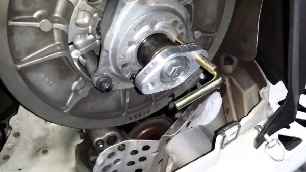

If you get or already have an after market secondary spring as I do, you will find it much harder to change your belt. I have lost some of the use of my right hand in an accident and needed a solution for changing my belt in the event I was alone. https://www.richmotorsports.com/store/yamaha-belt-change-tool-sr-viper.html I have installed the tool and it is literally a one hand belt change. I am not sure what if any the long term affects will be on the secondary. If anyone else has this installed please chime in.

If carrying the belt change tool on your sled it is a good idea to cover the threads with a hose or tape. The threads are not super hard and get damaged if bouncing against your other tools.
