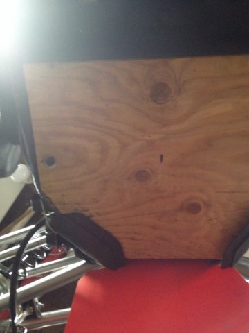

Check to see if your stock belly pan is still there.
After checking my clutches, I did find that the OEM plate was gone. Just ordered a shorty mountain tech plate, looks like a great upgrade. Made a "custom" one just for a ride today. Ply wood and a mud flap. Seems to do the trick so far.
Very haha, slowly figuring out all the little quirks! Mountain tech plate came in ! Looks a little better than ply wood and a mud flap!
