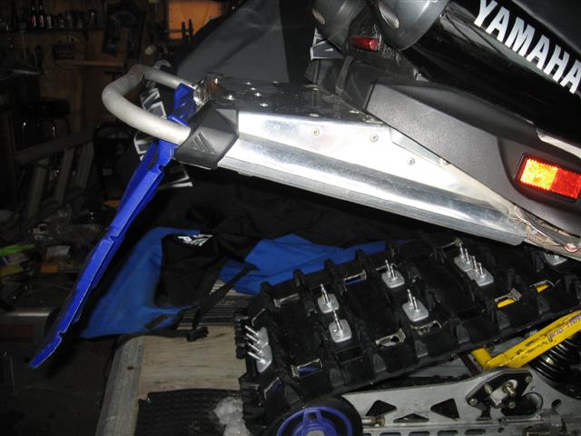

So I hear a lot on the site about the pros and cons between the new triple skegs and the dullys.
Triples, long lasting but dont entirely eliminate darting and with the ski savers impact top end.
Dullys, pricey, dont last as long but eliminate darting. I personally have 8" dullys and love them.
Whats the best stuff for serious riders??????

Bergstrom Triples........The dualies cause too much drag and can also catch on stuff. I witnessed a sled cross a set of railroad tracks (yes at the crossing) and his dualie caught and tweaked the A arms.

Have a little under 500 miles now on my 8" Bergstroms, they have a small amount of wear up front but this years' conditions??? I 'll tell you what the ski savers do work well as they take alot of abuse that the ski would normally see. Trying the Slydogs next season!
Attak-Firecat
I have about 800 miles on the Dooly's and am swapping them out for Bergstrom's setup -- Triple Points, Ski Savers and Shims. The sled pushes corners way too much with the Dooly's. They fixed the darting problem but created another one - really crappy cornering.

Has anyone had both sets, whats the dillio between the two? Hate to spend clams on the triple's if I already have the dullys and end up worse off.

"DUECE" bars.............................. They corner great with no darting. And they can take a beating....

I have had both duallys and triples on my Rage, and I like the triples much better. Just shim your skies like the directions show, and the darting problem will be greatly reduced. The duallys really did take out all the darting, but they push real bad int the corners. They also did sometimes catch when loading on trailer.

Push? I have run Woody's Dualies and Stud Boy Duece bars and have never had a push issue. It must be set up!

They must turn hard........ Bad snow would just eat them alive.. MM.

Someone here is running a Dooly on one ski and a single on another. Good idea, I might try that myself. I found that the Doolys eliminated the darting but did push A LITTLE.
