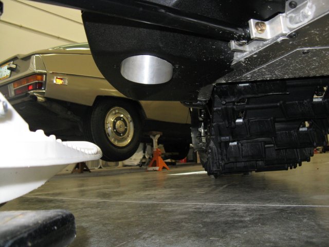

Hey I remember reading that the powder guys where installing a defector shield to keep the snow from packing into the exhaust pipe
I ended up making a deflector out of a piece of aluminum pipe. It does help with deep snow bogging, particularly when doing right hand side-hilling.;)!
