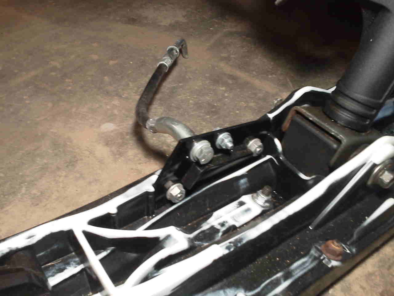

I welded a small tab to each of my scratcher's and use a second bolt to keep it from rotating or coming off.

BombaPolaYama said:Thanks for the tip. I may try mounting them on the spindles if it is not too high as there are no metal brackets (saddle) on the Slydog skis.northernsledder.jk said:.......
Mount your Slide Kicks to the ski's. I've yet to break a set and the tips change easily when worn down. Loosen the bolt and let the cable relax when not using the sled.
I made the mounting brackets that hold my scratcher's to the skis.
