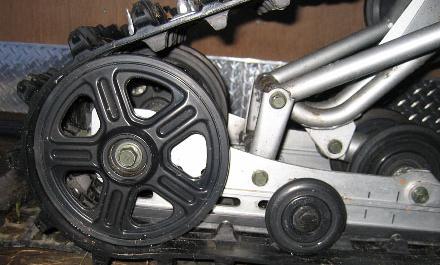

I put F-cat wheels on my 121 and if you go bigger you will be at the end of your track adjustment. i think these are just under 8".
not sure about your mountain though.
