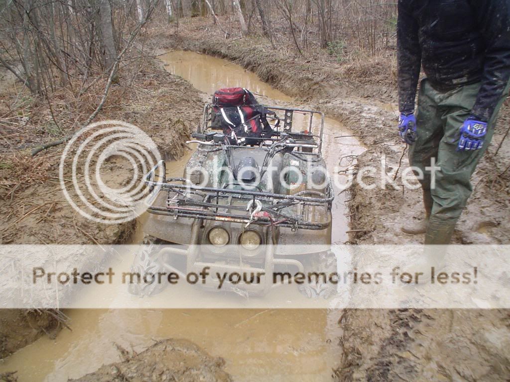

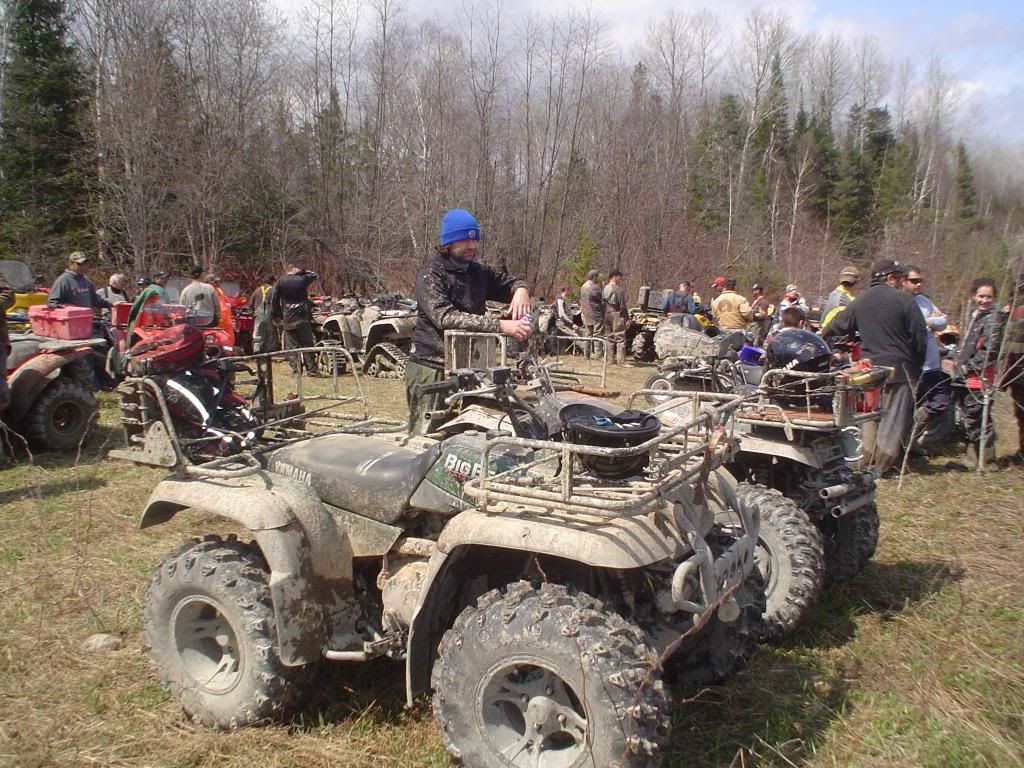

high centered
at lunch break
1992 big bear sitting beside on stock rubber.
griz in pic is on 27", canam is on 30"

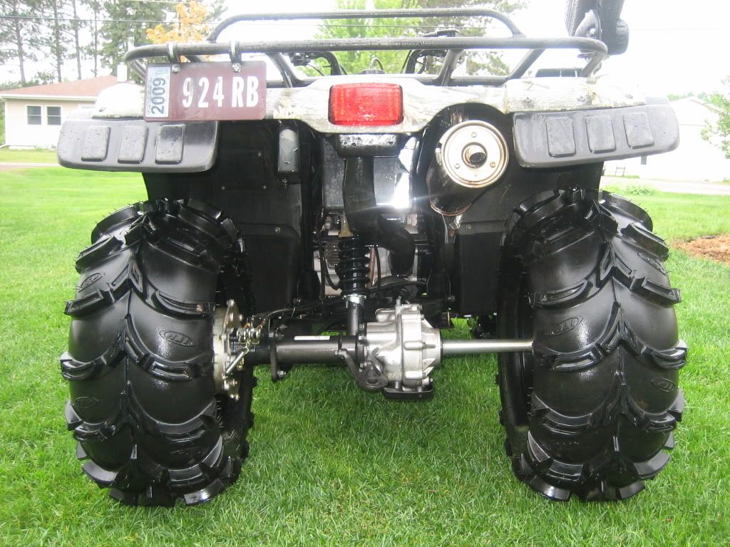

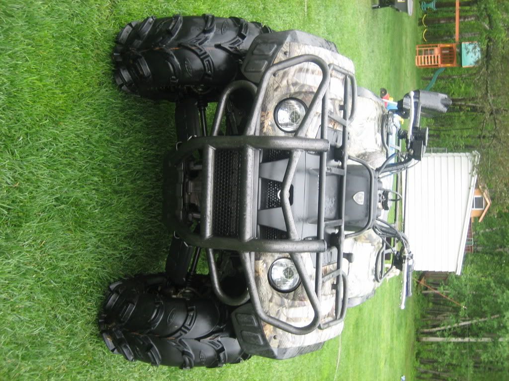

Pics...
Well here are the pics. I love the tires......
The tires.....
Some other pics:
The tires.....
Some other pics:
