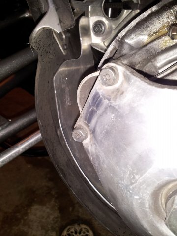

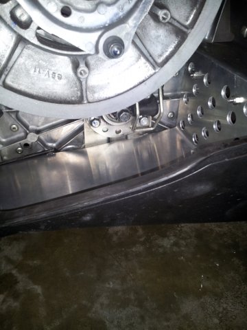

Good to hear. I installed mine yesterday along w his starter saver too. Real nice piece of work and solid. The starter saver is a great piece of mind aswell. The first pic shows the oem flimsy belt guard sitting on top of Nitris' new belt guard....good reference as to the area the old guard protected

Post some pics, interested to see it.
Thanks

Got my belt guard and saver from Nitris223. I told him it's almost a shame that it's out of site it's so nice. Great guy to deal and talk with.
