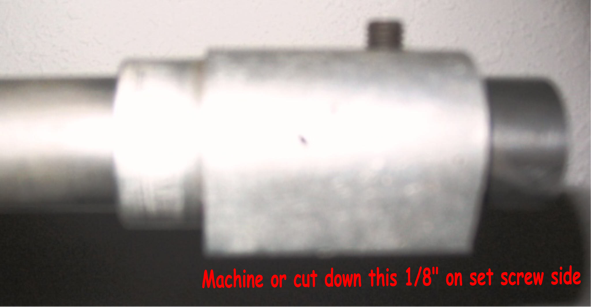

its easier to pull suspension.i just went thru this on my custom and since i had it apart i installed some oversize wheels that dont blow apart.you have to cut down alum. holder/spacer 1/8" off the outside bigger part( opposite of where it goes in wheel bearing.

oh and i used my miter saw with a 72 tooth carbide blade.cuts it nice and straight.
culvert
any pics of what you are cutting off? would like to know for when I have to change out my wheels.

i'll take some later and post.
