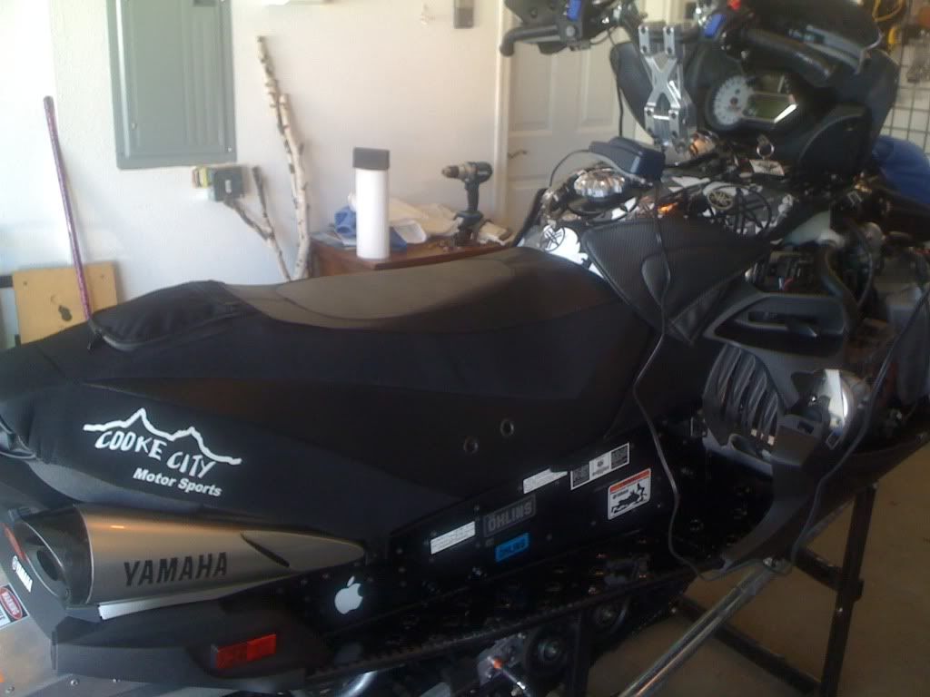

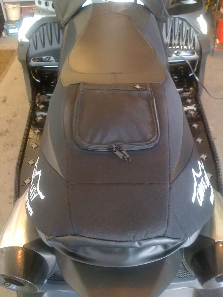

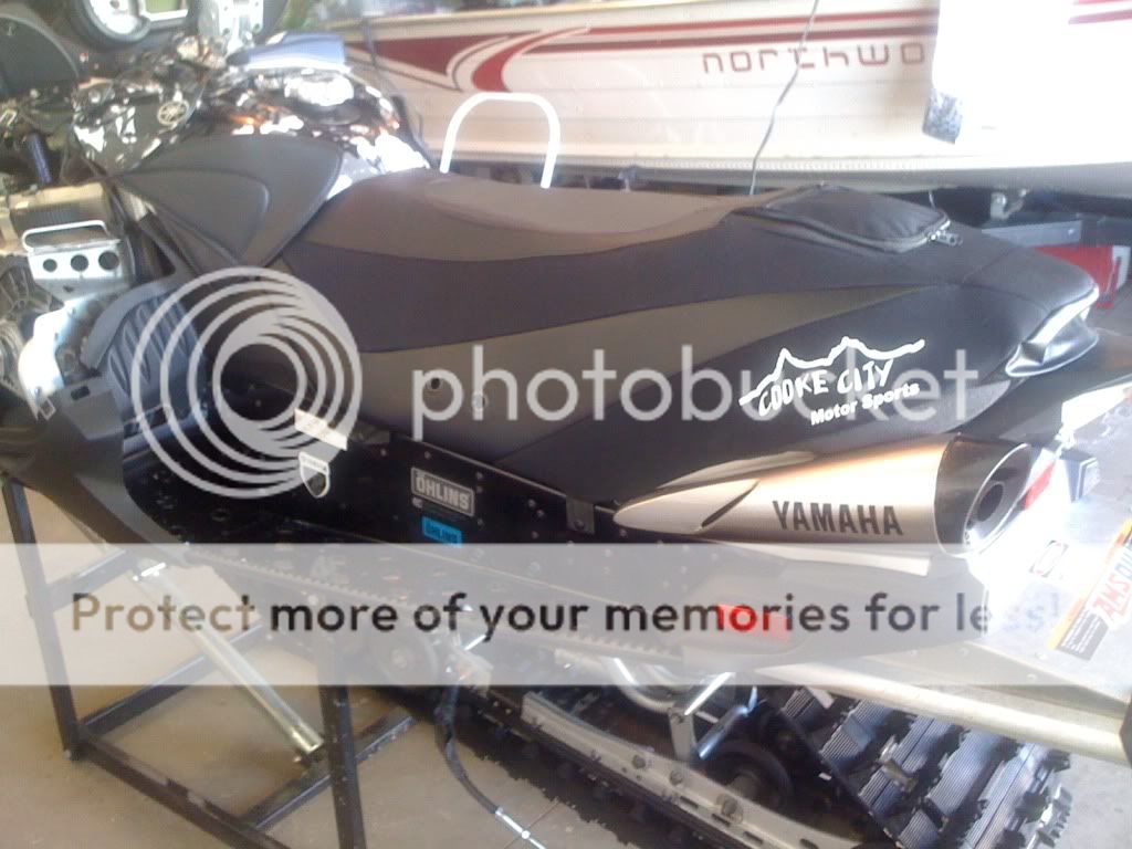

Here it is. I think the install turned out well.
Now can't wait to ride. Hopefully going out tomorrow for a looooong ride.
