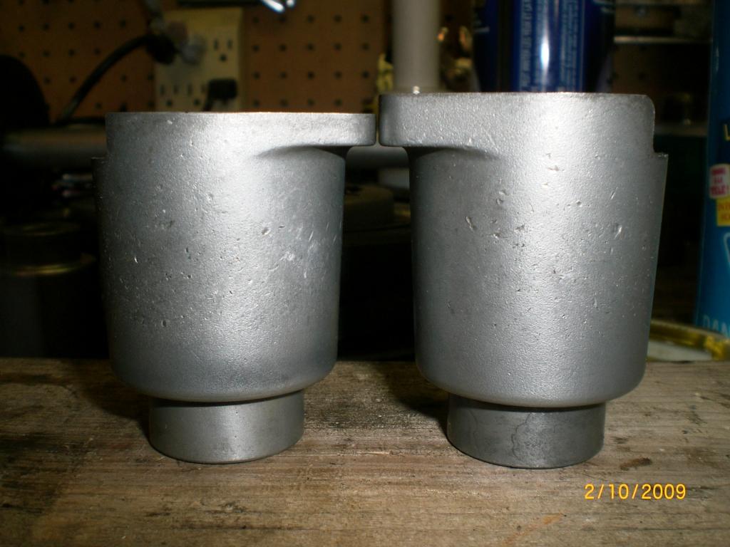

As per the first pic, grind off a bit to clear the rail, a bit at the bottom to clear hyfax and drill out hole to allow the stock bolt and nut to be re-used. You just need to get a bolt for the lower hole (I used stainless with a nylock nut) and corresponding hole drilled in rail. Second photo (from Rockerdan) shows it on the rail.
That's it. It's already at proper position so no further machining is required.
