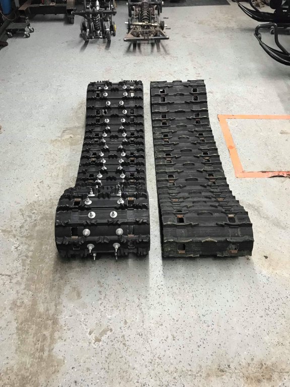

Hey guys asking for a friend we have a issue here
He has a 09 ER skid in his RX1 with a studded track and the 09 skid has boggie wheels in the Center at the front .
First ride he went out on the boogie wheels got destroyed !
Just curious if anyone has had this issue and if so can suggest some ideas to fix this ?

are the studs all sunk into the track properly?

What is that skid out of ?
I can tell you it's not out of any '09 Yamaha. It's still a Pro Action, or version there of, like an '05 Vector.
'09 Apex or Vector has a Monoshock.

looks like an ck skid from the torsion springs.
Are the studs properly torque down? If the heads are not sunk into the track they will chew up the wheels
