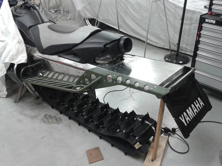

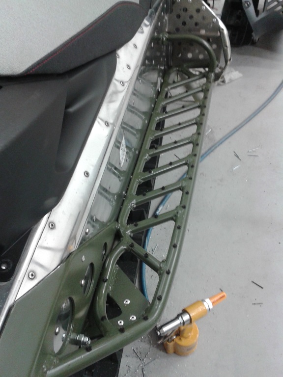

Got the hole rear end with runningboards welded up yesterday. That mean that all the fabrication is done :-o
Time to stripp everything down and get som paint on it.....
Powdercoated my runningboard-bumper combo "nato-green"
Plastidipped the hood camo-green
Got the wrong color for the spindles,rails and riser. Whem they are powdercoated it´s more or less finished :-o

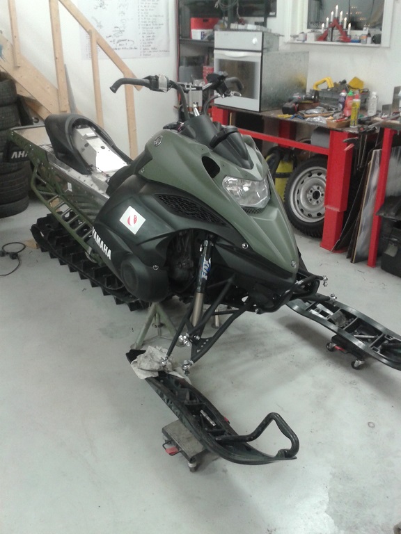

Really don´t like the look of the big old seat. Really thinking of a diy undertunnel exhaust to clean things out and make a custom rear bracket for the oem seat for now......

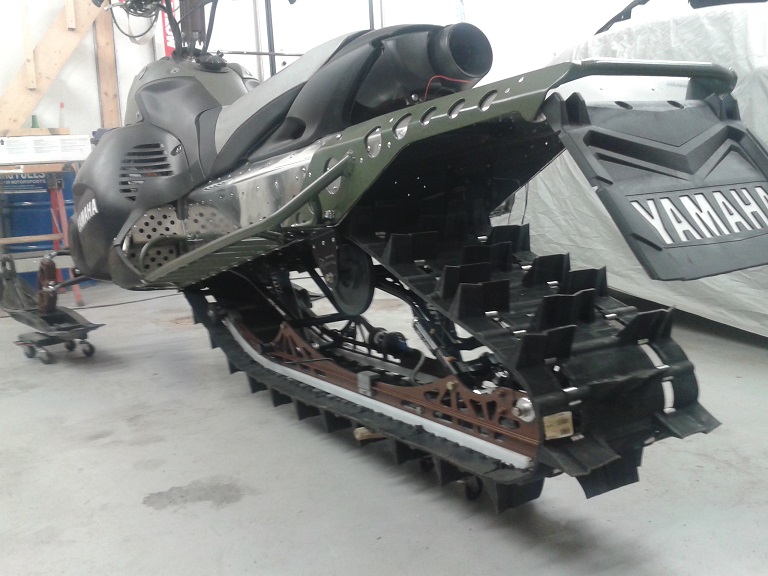

During the holidays I got the bronze powdercoat that I´ve been searching for. I think it turned out just the way I wanted. If I only could come up with the cash for a new skinz seat ; )
It was really nice to be able to stand on the sled for the first time.
The worst thing now is that we have the worst winter ever.......there is no snow what so ever #$%&*
