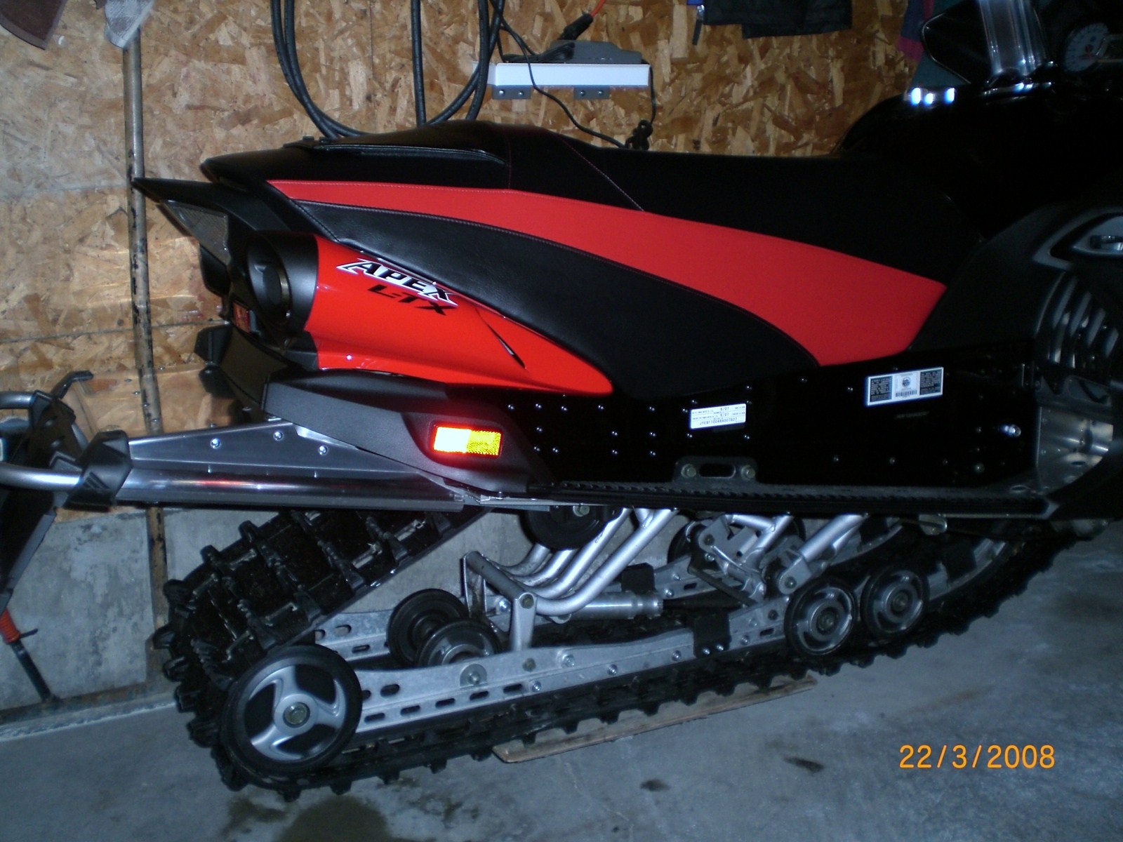

Funny you say that Dan, I've always ran w/130mm without any issues, over 12.000kms on my '05 RX1 and now on my '08 APEX w/10.000kms I have over 6000kms on set of HYFAX and still measure 14-16mm in thickness w/original RIPSAW track w/closed windows...I have a real good set of SCRATCHERS for marginal or hard packed snow conditions.

You have no idea how happy I am to hear that you like those type of ice scratchers that I see in your picture!
I just ordered and received a set of them from Royal Distributing in Canada (couldnt find anyone carrying this style in the states...hmm, money making idea, lol).
They looked to me to be the best style to achieve complete snow/ice spray of the track & hyfax.
Your comments and picture just re-enforce to me that i made the right choice and they were worth the wait...thanks!
