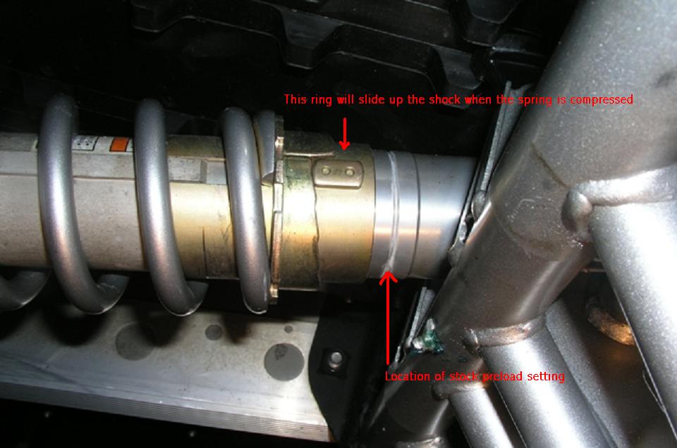

U can also move the clip on the bottom of the shock which will change the range of shock preload. There are 3 settings for this clip, the bottom one is stock. The spring has to be compressed to change this setting.
If u r bottoming out on the long sweeping dips (G bumps)I would suggest a revalve and that would cure u're problems.

I beleieve the original poster has an Attak GT, which means an Ohlins EC shock. If shock has never been revalved, it needs it to accomodate that rider weight. Same things goes for adding a heavier spring, it helps ALOT. As far as any other adjustments, you can just make sure your spring on your Ohlins is maxed out as far as pre-load.
There should be no more than 40-45mm difference spring length with shock fully extended (track off ground hanging and measure spring length) and you sitting on the sled fully geared (with sled back on ground), so it will see the same weight as when you're riding. Anything less than a 40mm difference would mean ylou have too much pre-load and could experiend coil-bind at the spring.
