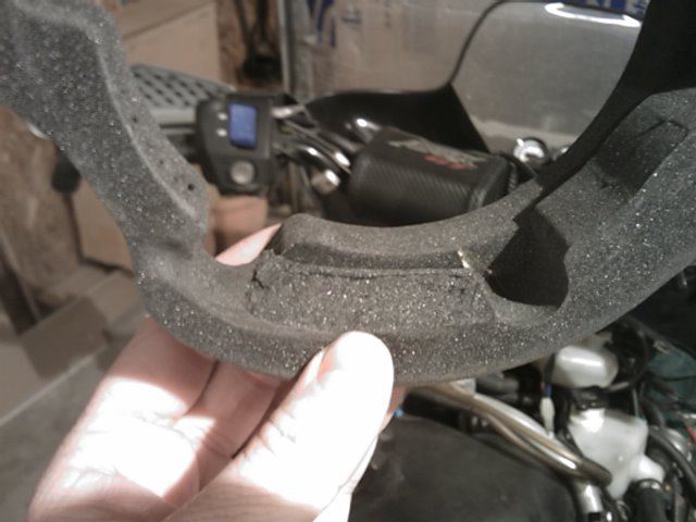

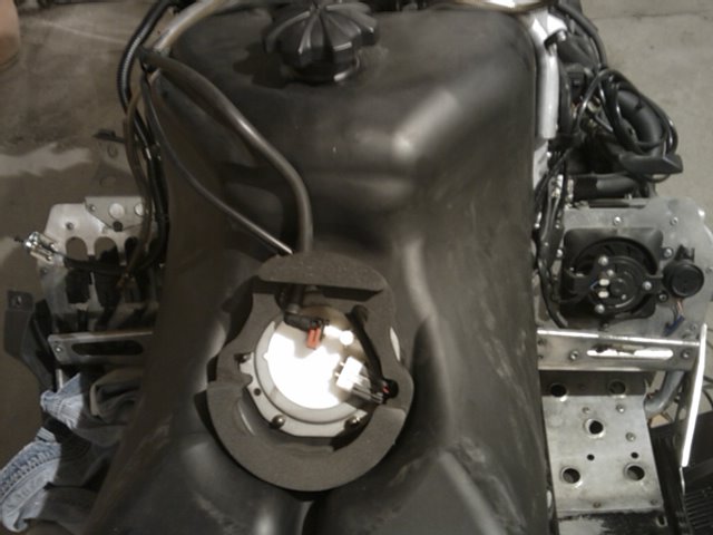

I didn't know that fitting swivels, I thought it was all molded together.
Thanks a ton DC5 I'm heading to the shop now.

All done works great, I got fuel now!! Went for a run and now it hits 10:1 at WOT, mid range is great at 12.5.
What would you adjust on the gems to only effect WOT?
DC5 THANKS AGAIN!!! Your a life saver I was dreading how I was going to make this work and being under the gun for our trip tomm made for restless nights!!!!!!
