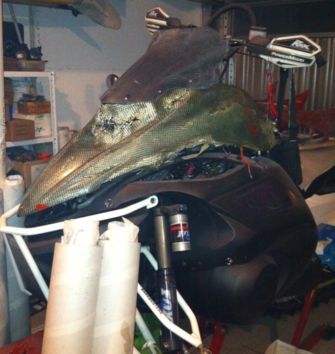

Here it is the CarbonKevlar hood and handsguard just pulled out from the mold.
In the next days I'll cut and finish those + instruments panel + fake headlight/air vent
Than I'll reinstall all instruments (clearing a little the underhood wire tangle).
Remote Start is on my table since last year![]()
Tether kit with roll over valve is coming from USA
Then just wait december to ride and ride and ride testing the c/k toys before spend much more money in other ck body panel and tunnel
The shocking colour is not so bad in real life ... for now i'll keep natural ... than i'll decide if paint it or not

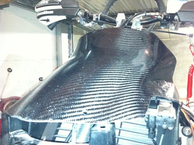

Unfortunately I had to give up on Carbon-Kevlar parts because:
- with same thickness are much weaker than those in full carbon
- weight more than the full carbon
- the finishing of surface and edges not reached the level that I want. When I sand and cut the CK, lots of filaments are produced and the result is that the sled seems to be wearing a wool sweater
... but this is a personal technical fault ... need to do more experience.
Maybe I'll use the ck as internal reinforcement when I'll make the chassis and suspensions.
However, ladies and gentlemen, here are the first components finished and ready to be assembled ... hoping to put the sled on the snow this WeekEnd for a short test.
Sorry ... poor pictures take by phone.

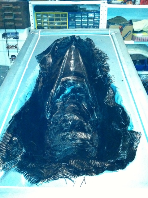

May be not easy to understand ... my new full carbon hood still in the mold
