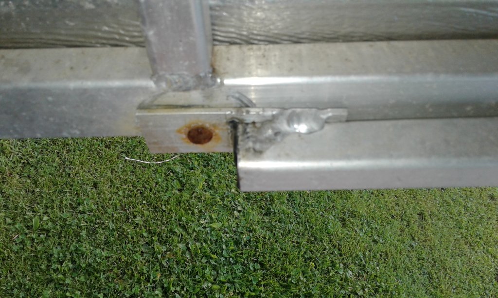

This is whats on mine don't think its factory?

Mine is similar to that but a bit further to the rear. On the clam top there is a tapered head bolt going thru the rail with a nut inside. (the tapered head allows the lid to close better than a pan head) Where the prop pole meets the floor when the top is open I drilled a hole thru that aluminum side plate and stick a pin thru there to secure it when the top is up. My trailer is 12 foot so the top is darn heavy and actually installed a pole on each side. When I get ready to close the top I pull the pin and move the pole to it parallel position with the lid's rail. I have an aluminum L bracket screwed on the rail with a hole in it and the pole and I put the same pin thru it to hold it when it stowed. It works. If money was no object the clamshell trailer would be the first thing to go though.............
