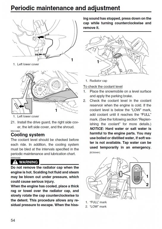

Hey guys,
going over my sled before the season starts and noticed that the front coolant bottle is empty. that should have coolant in it right? I dont have a manual so . If it does what kind of coolant should I use ? Yamaha ?
thanks

Manual pages attached here... there is a window behind your port side shock, full and low, no plastic removal to view it... if you don't see coolant in the overflow tank you might still be ok as it is essentially an expansion tank but why risk it, top it off with ONLY Yamaha coolant (blue, special coolant) just so you are not the guy stopping your friends.
