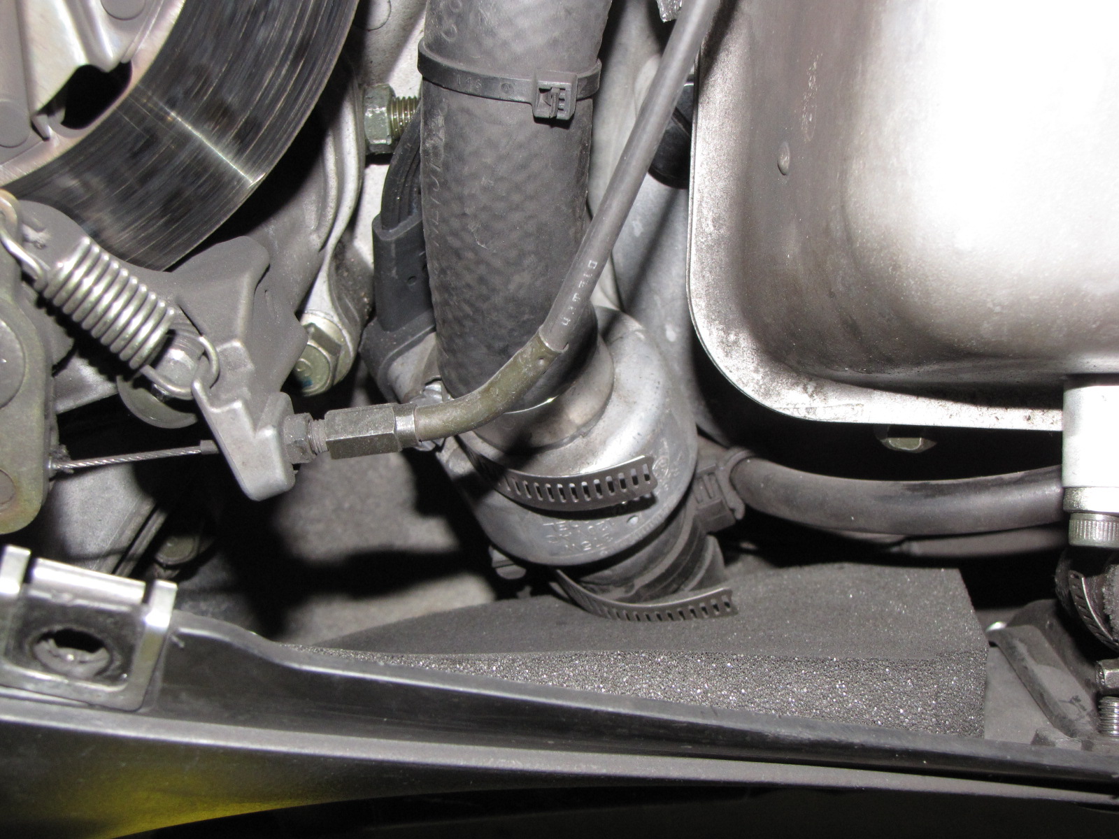

Also here is a pic of the coolant heater location. I think its 50mm from the bottom of the hose, section out 25mm of the hose and then install the heater.

Mine is installed a little higher then that photo and works just fine. But that's exactly where to put it as far as which hose to cut into.

Thanks for the pics! I was reading on this site and some people are saying if you put an inline heater on a fuel injected snowmobile, it messes up the thermostat reading and makes it dump fuel into the cyl.s??? And fouls the plugs allot?
Take A Hike
These people were saying that when the engine is warm (having the coolant heater going would make the engine think it was warm when it's cold) it dumps more fuel into the cyl. But that is wrong. When an engine is cold it takes more fuel to keep it running and when it's warm it uses allot less fuel. So I don't think I am going to pay much attension to what they were saying.
