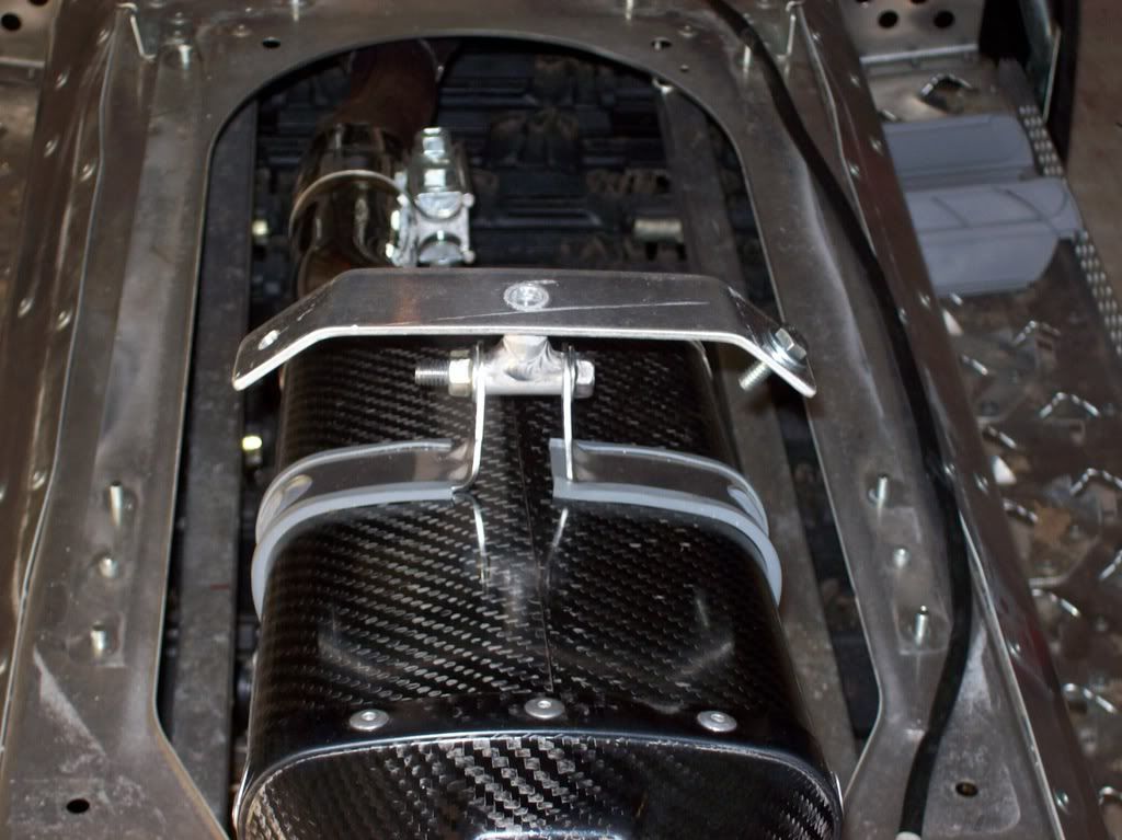

i got my pipe on ebay for 330 canadain. as for pics it looks exactly as the other pic. s but i have a 40th edition and i have it sticking out slightly more . y camarra screwed so ill try to post some

what year exhaust is better to fab 05 06 or 07 08

why i ask is the 05 06 mid pipe is a little straiter than the 07 08 so for the mod i was just wondering what was easier

So what is better to go with 05-06 pipes or 07-08 pipes? How much welding and cutting is involed to get the pipe right?

From what I've seen of others who have done this mod, the better way to go is with the 07-08 MY. Mine is from an 05-06, and the mid pipe required a bit more work to get the proper shape needed to line the muffler straight out the back. A good welder can have this ready in no time. I believe you need an 'S' shaped mid pipe 10 inches long, and the inlet and outlet needs an offset of 3 inches. This will allow the muffler to be centered straight out the back, and at the same length as the taillight. ( on a 121)

my guy didnt use any of the mid pipe he fabbed a small S pipe that fit into the can and onto the nytro exhaust header
He charged me 100$ for everthing just make sure the sled is stripped down before bringing it to him

Skoalring11 What brand is the exhaust clamp and where did you buy it
NyTrOMaNIaC
The clamp that wraps around the muffler comes with all Yosh pipes as long as you purchase new or like new. I'm not sure what kind he used to attach the mid pipe to the header, but it does look beefy and strong and will definitely be nice and snug.

i seen and heard an xtx with a gytr silencer on it today,way too loud for the northern Maine i think,looks like it slipped right into place,think it was for a raptor 700,one little bracket had to be fabbed by the looks,again,looked good sounded good but way too loud for the Maine wardens
