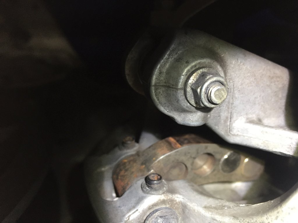

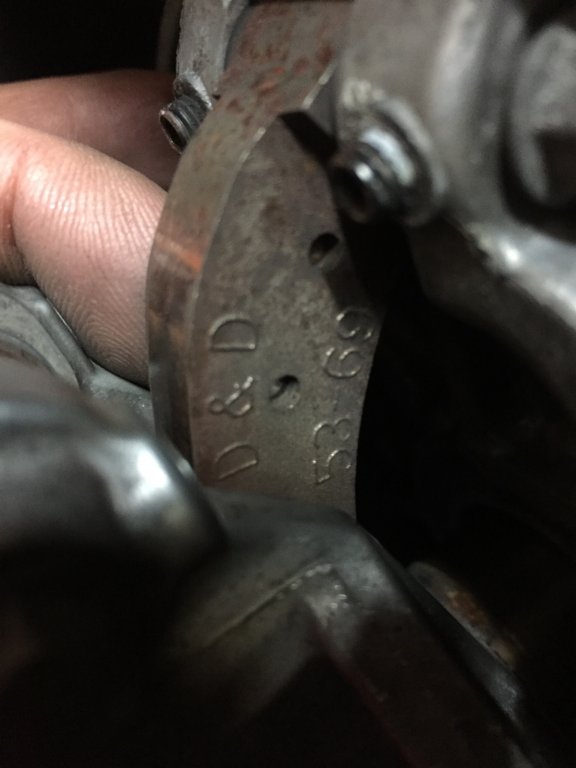

Just wondering if anyone else is running the D&D Magnaforce kit on there Viper, if so what weight and helix settings are you using? I was using the set up that D&D recommend with there Quiet tech muffler- helix 6-2 and weights 0-3-2-3. This setup was really lacking top end and WOT rpms where only 8400. Changed weights to 0-2-3-2, giving it more rpms but not much more top end. Only getting around 85-86 mph. Wondering what helix and weight setups others are using with this kit for good results?

2-1-3-3 with mods+Ignition 92Octane Premium pump gas 107mph on 6" Packed snowcovered Ice. 9050rpm. Is dead nuts on every run and Stock secondary spring 6-1 Ulmer K Helix. Setup is dead nuts on and repeats within 2-3 rpm everytime. I am almost full of magnets now though.This was with theUlmer/ Straightline can.With Ulmer stock modded exhaust 1-0-2-2 87 Octane fuel no ignition 90-100mph depending on trail conditions 9025 rpm. All with 8dn belt. There is more speed there just need to make some runs somewhere.

Primary has a shorter pink and orange spring in it. Im gonna try and take some more weight out of the middle and see if it will help. The first holes closest to the pin ive never tried weight in, what would that help with? Was thinking of try 0-1-2-2

Closest to pin helps launch and engagement. 6-1 may make your rpm even lower. I run a Orange-Yellow-Orange in primary. Do you have the tool to open Primary clutch up without removing cover? If not get it. Takes less than a minute to add or remove Magnets then.Im running a stock spring in the secondary at 6-2. Would taking it back to 6-1 help with anything?
