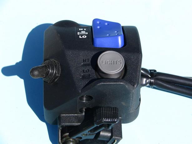

I did away with the OEM dimmer switch on my 05 Rage and installed a toggle switch closer to the grip. The OEM switch is in a good location IF you have hands like Wilt Chamberlan ot Shaque.
The new switch and location are much easier to reach in a pinch when there are oncoming riders and while standing.
Just go to Home Depot and get a switch, some rubber boots and silicone it up in the back to weather proof it. Mine has been on there for three years with no problems.

they have to get them from Yamaha Service Dept. (RTA) they will have them ask dealer to call there RTA and they will send them. also the stop switch buton also
