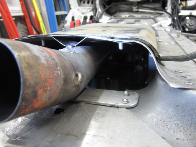

What kind of replacement pipes are you using? Since I have gone to the stainless steel pipes I have not broken or cracked a pipe.
How close is the track to the exhaust? Even with the tunnel protectors in place I found the track can still slap the pipes.
I have welded my protectors with a spacer to eliminate the squish of the factory u shaped mount as well as an extra support in the rear of the exhaust system(pic in above post).
As others have mentioned, grinding off a few thou of the clamp spacer also keeps the flange tight with the flex pipes.
The front exhaust hanger on my sled also needed attention. I had to add fender washers to the rivets because the holes were badly worn.
The factory exhaust is heavy. Keeping it tight will help the donuts and the rest of the system healthy.

Why does it look like your stock rear tunnel reinforcement has been cut out and covered over with another plate?
