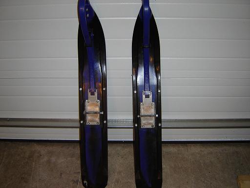

I removed the drive axle on my sled for bearings servicing. When I got the sprocket shaft in hand, I notice that the `'teeths`' of the sprocket are 1/16'' higher than the wheel itself. I mean if you look at it from the side.
could this generate noise (mine is fact very noisy). And what if I shave the teeth level to the wheel itself ? I asume the track would wrap around the sprocket much smoother.
Andre.
