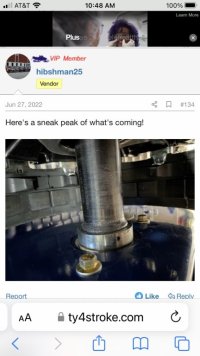

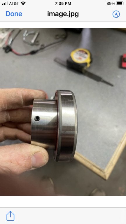

You should reach out to Travis Hipshamin at Barn of Parts.He could save you a bunch of time and labor by installation of his new concept lower Driveshaft bearing repair.You can keep your existing shaft and install his custom bearing and collar assy that locks to the old drive shaft.You can call him during normal business hours .717-821-9639.The new concept cost $160 with the custom collar pressed into the ID of the new FAG bearing.Best $160 you will spend on your sled.Check into the updated Top gear by DMC (which he sells) and brass shifting forks while apart,and check the (2) tentioner screws are secure.

I did look at the Driveshaft Repair Bearing BOP has, my concern is that by eliminating the clip that the bearing sits against isn’t it possible the driveshaft could move and wear inside the chain case if the set screws became loose or if it’s installed in the wrong location? Also the bearing collar would have a gap between where the bearing sits and the worn shaft so is there not some higher potential of bending/warping the shaft or collar? Having some issues with the BOP site right now.

Travis has an earlier thread on the issues you bring up.There has been no evidence of wear on the snap ring,indicating any movement of the brake side bearing towards the snap ring.As far as driveshaft laterally moving sideways,the is a shoulder and snap ring on the chain case side. There was a third cupped Allen screw that was also added to prevent slippage.And adding loctite to the 3 screws.My post was intended to save you the cost of another shaft and removal of your drive sprockets. Travis could address any concerns by calling him.good luck for a great season

Buy the driveshaft repair kit from BOP
All will result in a longer lasting driveshaft, all three options revolve around 1 of the 2 solutions (driveshaft saver or driveshaft bearing repair kit).
