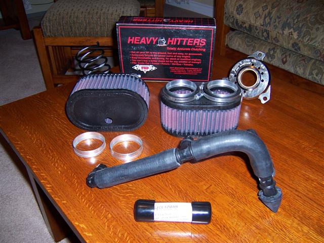

RX1Jim,
I bought the CPR supertune kit from Matt at The Speedshop this fall.
This thing wakes up the bottom and mid-range big time - however like some others on TY I have lost a bit of top end - max mph 103 -105 on a hardpacked snowlane at our local lake dragstrip. I have not played with the clutching as our winter here has been so spotty but am over revving at 10600 on the full pull.
The kit picked up about 5-6 hp over stock - dynoed at 142.6hp.
There is a thread from back in November 05 about the cpr kit started by myself - several interesting comments from the tuners and others who have this kit. The dyno graph and pictures of the kit are in that thread but I will post a picture again here in case you can't find it.
My 05 will pull with a new stock Apex to the 660 ft mark but by 1000ft I'm four to six lengths back. A couple of runs I got out hard and got them to 660 but they blew on by. Not exactly what I hoped for but then again they are still up several hp stock and are lighter. Can't change the laws of physics eh?!!
Overall I'm pleased as it is way more responsive at trail speeds and starts and runs as clean as stock. I quess we should all build one for the lake and leave our trail sled more or less alone!
Hope this is of some help to you,
Peter

Thanks for the pictures of the CPR kit. It is a nicely engineered kit. I like the idea of those aluminum rings, they allow a much cleaner installation on the carbs, right where you need the installation to be clean. Tou want the transition from the filters to the carbs to be smooth. If you just "squish" the filters down to seat on the carbs I think you may pickup some turbulence in the air flow, right where it hurts the most. The CV carb are very sensitive to turbulence at the input. I made a set of these rings for my setup but included the EVAC connection on them as well to clean up the appearance.

Ummm, I was just curious after seeing those pictures of the CPR air kit. I was e-mailing back & forth to Freddie back in the fall of 2003 and he (Freddie) sent me some pictures (to tease me) about these velocity rings to put into the kit to improve air flow. I could be wrong but those rings in Jeff's kit look almost identical to the pictures I saw from Freddie. So I was wondering if Jeff (From CPR) came up with these on his own, or does he get them from Freddie AND my big question is how do they work? Should I add them to my air kit??????..................Cubby

Cubby,
You are right, 2 years ago when I visited Freddies shop to talk to him about his kit he showed me the velocity rings and they look exactly like the ones posted in the picture above. In fact, everything in the pictures look exactly like the combination of Dynarex's and Freddie's work. I say let's support Freddie the way he has supported this forum with his expertise. Look at the volume of questions he has answered on this forum plus the huge amount of his own time he spent on developing the kit. Personally i think sales of the filter kit should have been left to Freddie and the clutch kits to Jeff. Freddie is a terrific guy, he has answered a ton of my questions without ever giving me the brush off. He is really dedicated to the performance industry and not in it to make a fast buck. Freddie's shop is 75 min. from me and I'll drive out there any time to buys parts and service from him.
