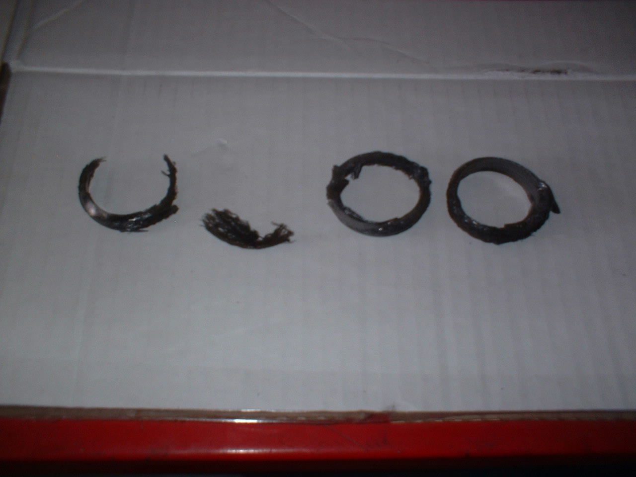

Mine has gone twice now covered under YES
03griz
Mine were bad too after this weekend's ride. Could here it vibrating. The donuts are $16 to $18.50 EACH depending on which dealer you call. Pretty expensive I thought. Hopefully they are in by friday. Otherwise the snow might be gone.....

The doughnuts are a little cheaper here in MI.cost me 43.00 and some change for the four of them.
Also when i put mine back on I took .020 off the collar that stops the exhaust clamps from tightening down any further in hopes to make the connection a little tighter and hopfully last longer.
