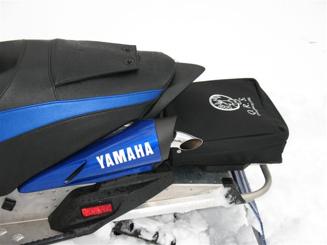

I bought mine at an auto parts store to keep the heat off the bag. Cut them to the right size, slip right over the stock end.
They look very close to the ones that THKSNOW has pictured above. Go to Port Yamaha (site sponser) look in the yamaha oem parts 2010 for snowmobiles and there under exhaust or call them and they will send you a catalog.
My buddy got the Yamaha ones they eventually came loose and needed reriveting, but they totally eliminated the ice/snow build up on the taillite
