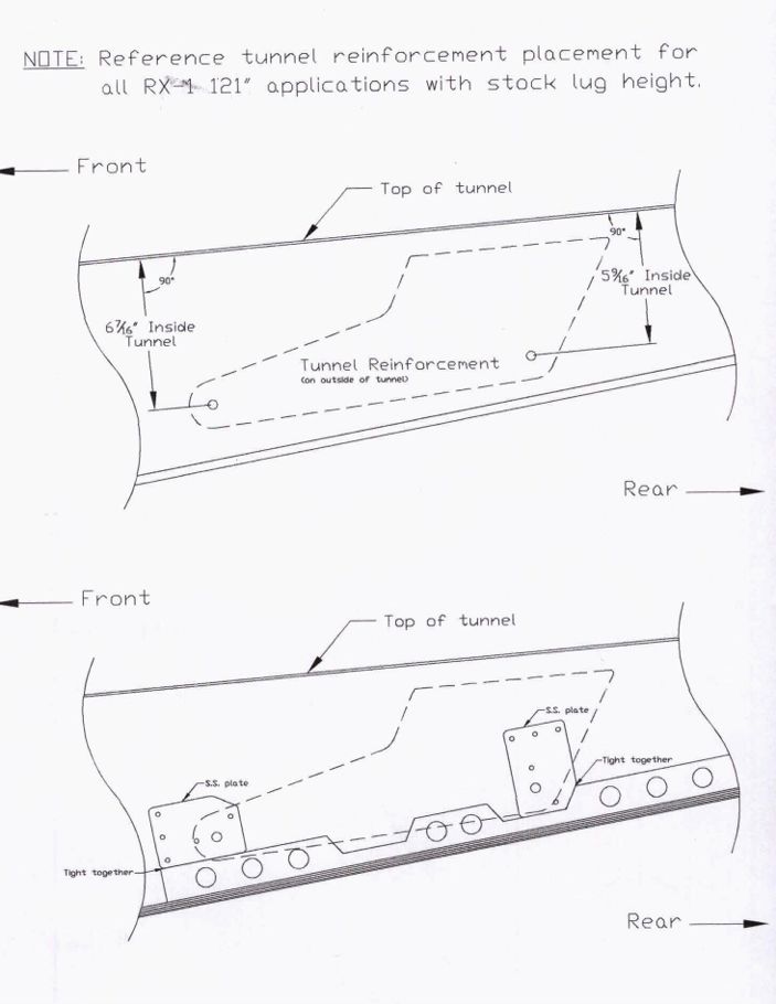

I bought the kit used and it has the mounting plats for the outside of the tunnel but I need the know how wide are the mounting plates on the inside of the tunnel that way I can make some at work tonight
lawmanbsi
2 5/8" x 3 9/16" 16ga stainless steel. I don't think the size is so inportant as its the rivets surounding it. I beleave they give the correct rivet placement in the tech write up. with the set back I had to cut some of the heat exchanger to get the inner plates in.
I used the measurements that where given in the instructions for the front hole 6 7/16" down from top of tunnel and the rear 5 9/16". I could give you the set back measurements, but that would take away from your experience.
http://www.totallyamaha.com/ExpertX_M10 ... exxrx1.jpg
http://www.totallyamaha.com/ExpertX_M10 ... nstall.htm
