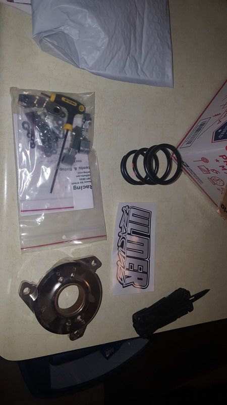

Ulmer clutch kit, Tuner skis with six inch inside eight inch outside woody's carbides, Evo chip for more power, take some preload out of your front shocks, preload front shock in rear suspension to two turns past loose spring and OFT relocate and you will love it.
