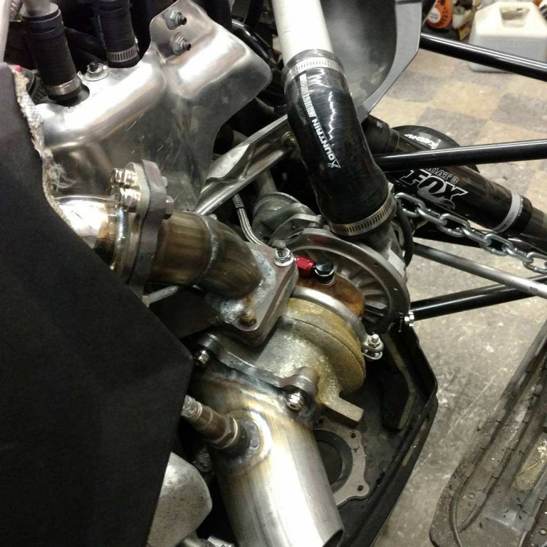

I will post pictures of the beast sitting low down to the ground with a 3" open exhaust exiting the hood on the right side. With it this warm my cameras should work so I will be shooting video also.

Allen testing stutter settings and has skid installed.

stutter is control through the PC"V" controller and allows you to raise the revs to just under clutch engagement to spool the turbo. That is the popping noise just before he pins the throttle the RPMs are being restrained and the fuel is not all being burned thus the popping and flames out of the exhaust.
From a idle start I am leaving with probably 160 hp max, with the revs at 3500 rpms I am probably closer 1/2 way to the wide open throttle HP at launch or in the ball park 250 ish hp, under load and at WOT I was hoping to get close to the 400 HP threshold. Over a year ago he did a track dyno pull that translated from track hp ( which is lower) to crank hp at about 365.
