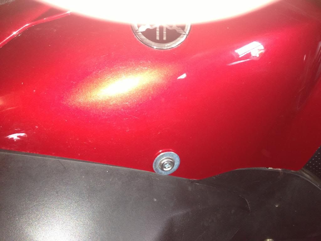

Here's mine

steiner said:
Yeah I don't see anything either lol

Sorry guys. Tried from iPhone unsuccessfully
I had a repaired tab (JB Weld) for 2 seasons. It broke again this season so I made a new tab buy using a screw, various washers to spread the force, a spacer and a blind nut on the end. The exterior appearance matches my map holder snaps and does not bother me at all.

Re: Sorry guys. Tried from iPhone unsuccessfully
You might want to apply for a job at Arctic Cat...JK. javascript:emoticon('
Seriously though, good option, doesn't look bad and its better than having the side panel flop around!
actionjack said:I had a repaired tab (JB Weld) for 2 seasons. It broke again this season so I made a new tab buy using a screw, various washers to spread the force, a spacer and a blind nut on the end. The exterior appearance matches my map holder snaps and does not bother me at all.
