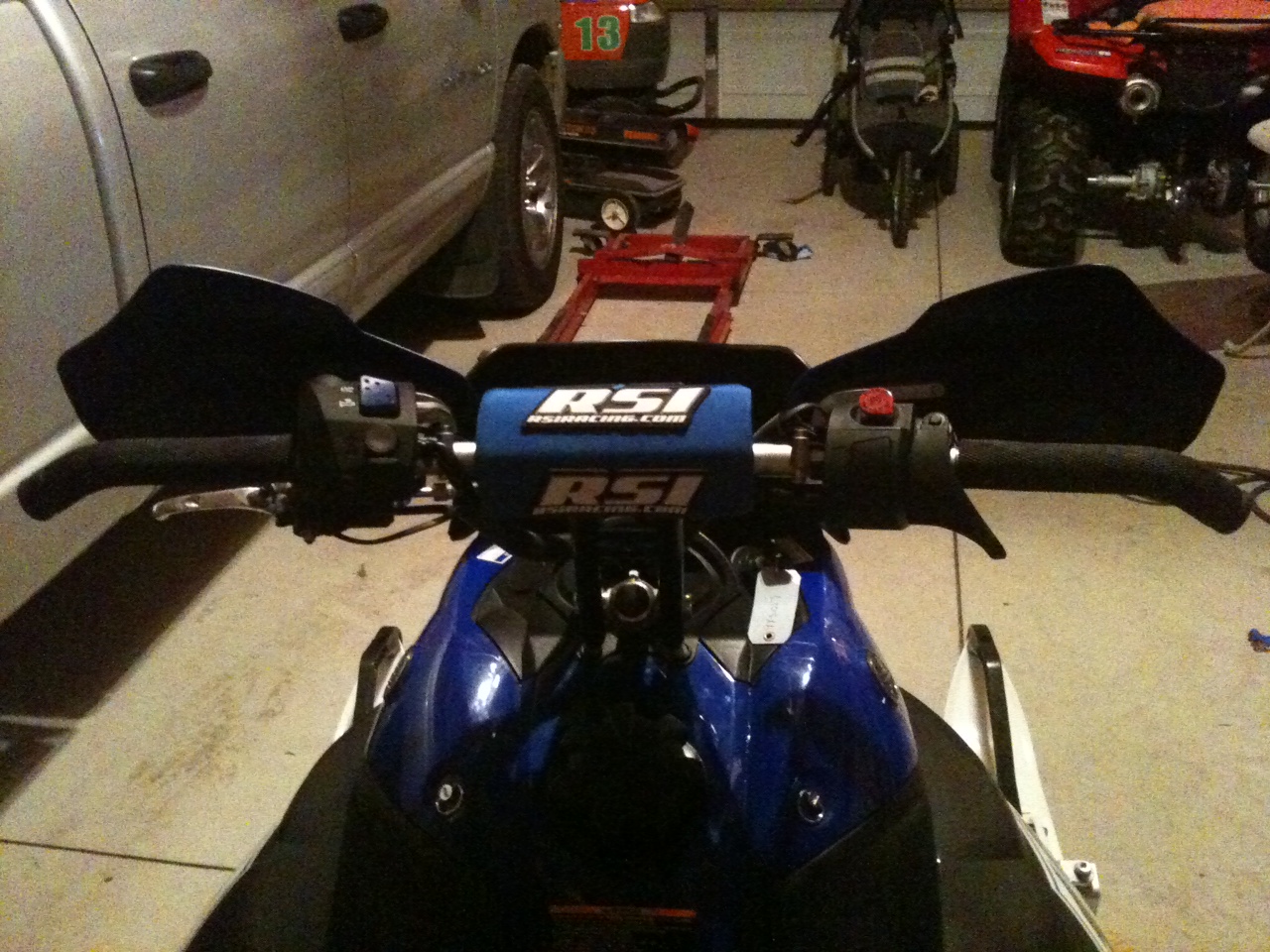

I have a 6 in lake effect with flat doo xrs bars. No issues. I also just installed the oft relocate last night and no issues either. If you don't have the bars yet the doo bars are alum with hooks on each end.
