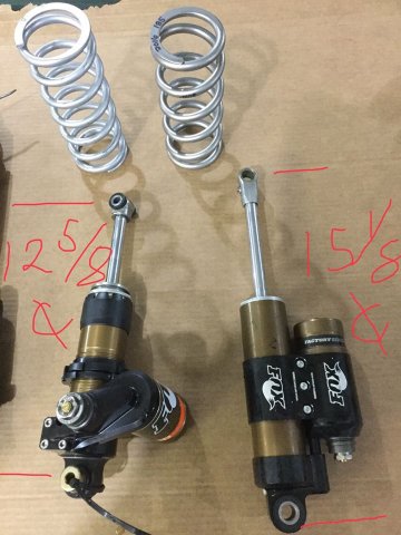

Polaris shocks are too far different in length to make them work on the Phazer, Fronts need to be 15.5-16.5" , Center 13.0-13.5" and rear 17.25-17.5" to fit. The only other current sleds that comes close is APEX (16.5") for the front and Skidoo SC3/4/5 NON-Renegade rears. It's possible you could get a .75-1" spacer put inside those floats to shorten them but then you loose that much travel. I have a set of Apex Ohlins on the front of my Phazer that have .5" spacers inside to shorten them to 16"
