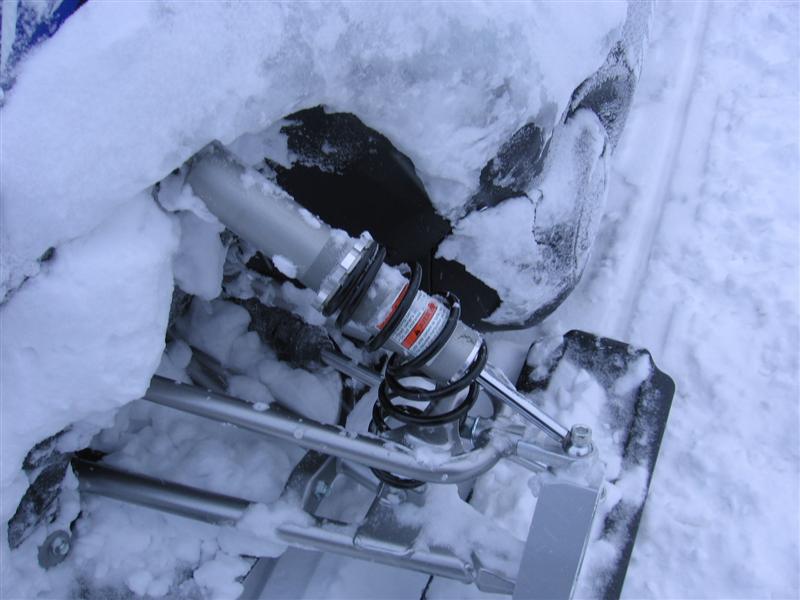

This happened to me this past weekend. Both on the trail ride back, in whoops, about an 1/2 hr apart (6miles). I hope Yami comes thru for me.
I'm going to try and get them to upgrade to floats and let me pay the difference.

Ouch! Suprised they snapped there rather than bending.
