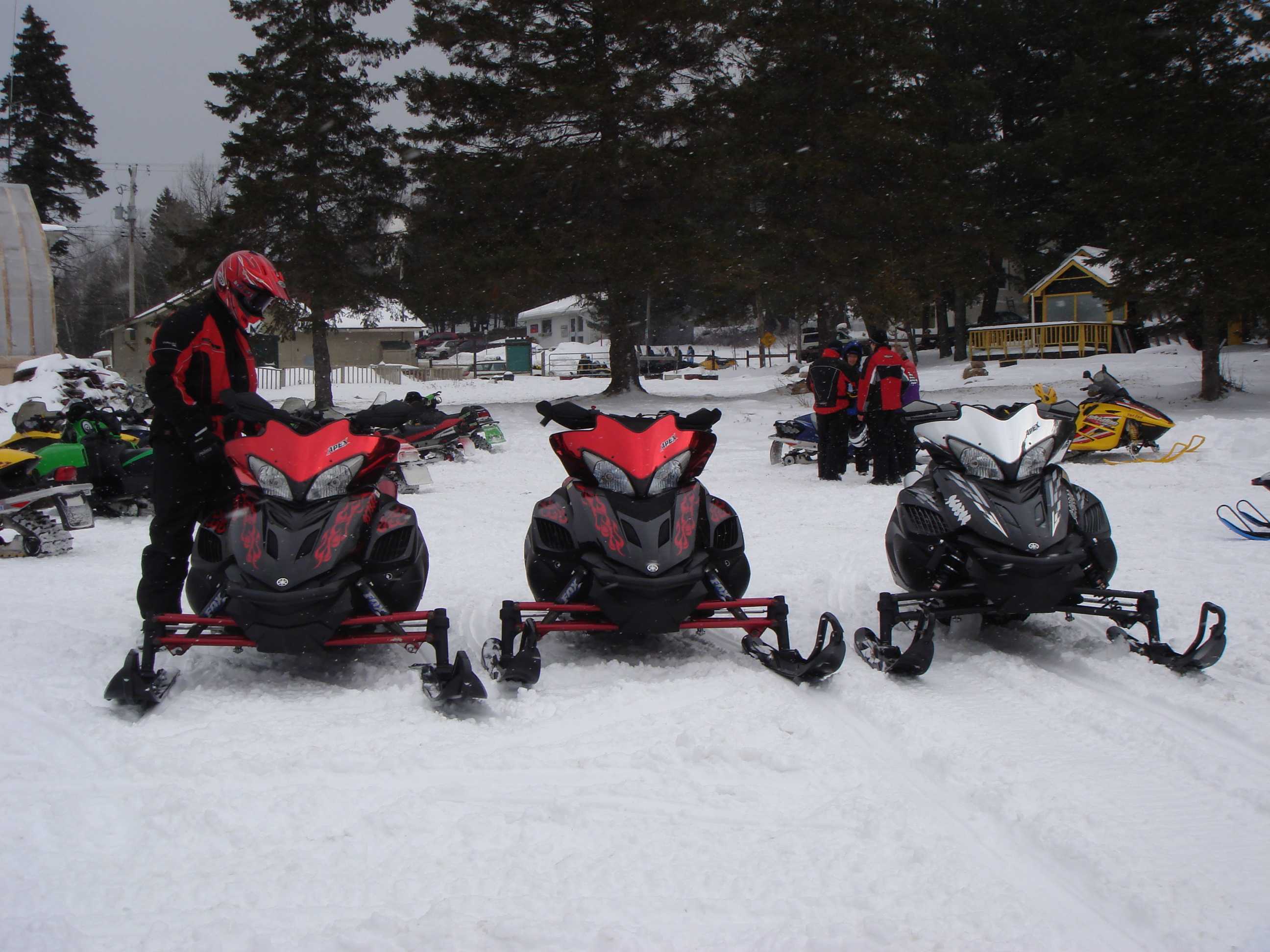

if you want to make it turn and stay flat..you need to lower pressure to 35-40lbs without weight on it....you need A arms level to ground..this helps Immensly....I rode many sleds with 65+ lbs and near flipped them over...horrible.....
for even better cornering you can add 13mm swaybar,this makes it an incredible railing sled...
all this is with pilot skis and shaper bars...with Yammie skis i cant guarantee any of this,cause anytime ive rode an apex with yammie skis i want to puke..lol
see pic below..this is how a well setup rtx is in front end..we lowered the GT later that day to where the RTxs are,and it also rails now....Dano(member) on left and My RTX center and Kyle(member) GT to right....Dorset,Ontario on saturday....click the pic for a larger view.

Just to add my .2c. I think its also a good idea while front end is lowered is to pull up limiter straps so that there is equal ground pressure on front and back of track. This is easy to test on a hard packed road or garage floor. When adjusted, it will give great traction for hole shots with the transfer set to full.
Oh, and another good idea is to add a skid plate while the front is low to the ground and vulnerable. Couldn’t help to notice that 2 of the 3 above apex’s in the pic are both missing skidplates. lol
