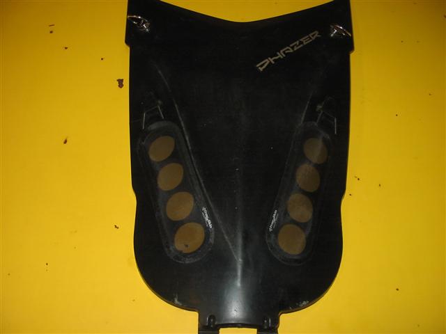

UP bushman
Here is my air box cover modified with the FROGZskin product nothing but cold protected air under the front body trim cover. As you can see the bottom of the air box is selaed off including oil breather which can't be seen.
