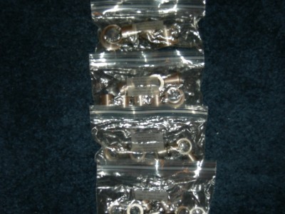

Here is what the kit looks like, as you get repacement bushings for the Bulk Head [front and back], A Arm [upper & lower] & Spindles
