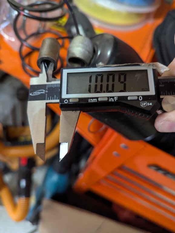

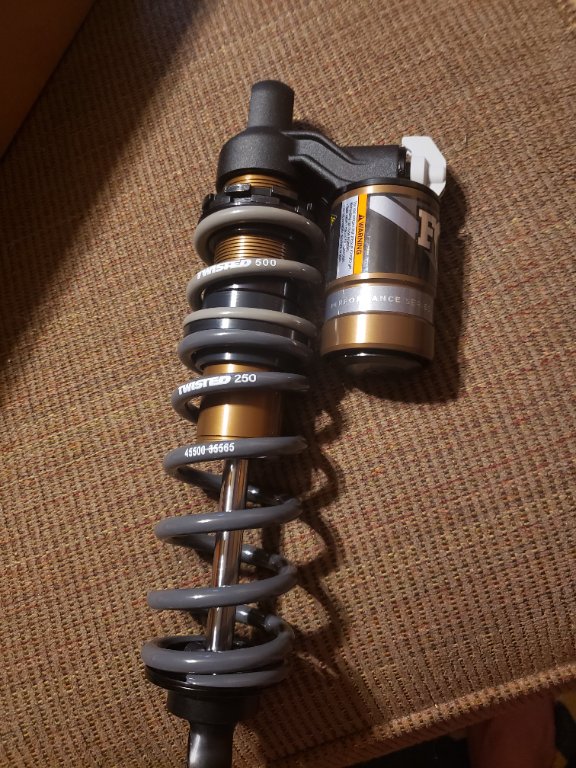

So I just ended up pulling the suspension but now I have questions.
I got this shock at the last chance sale last spring.
shop.arcticcat.com
I went to install it today and I ran into some issues.
1)The bolt is smaller than the hole
2)There is a spherical bearing in this vs the bushing that was on the original
So I will need to pull the bearing out and it looks like the RR parts should work
But has cat changed the eyelets over the years?
12.36-in Front Arm Shock

I put that bushing in mine but I cut and old lower center shock cross shaft and installed that chunk in there instead of the large chunk.

Here is the shock i put in mine.
Works really good.
