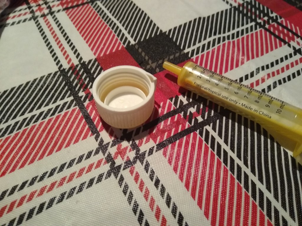

After some further searches it comes down to, if needed, appx a cap full per gallon. Or just to the top of the threads on the boostane cap. 7.33ml per gallon.

The official Boostane chart shows .26 oz/gal. turns 91 octane into 95 octane.WOW, Jon.....very informative....and relieving, all at the same time. Since we both ride in similar conditions.
I don't trust very many gas stops any more. I always am running this Boostane percentage at every fill. For my riding, I carry a couple of 2 oz bottles in my sled. Each 2 oz bottle is good for 8 gallons of gas. In the Midwest where I ride, gas quality (octane) has gone hill big time.

Yep, there's a bar with a single pump that looks like it didn't get used much, lower UP (Cisco chain) pretty sure my sled got COVID that day.The official Boostane chart shows .26 oz/gal. turns 91 octane into 95 octane.
I'll see if I can jam the bottle in my tunnel bag. If not, I'll find smaller containers to put it in.

I have found empty sea foam cans dont leak when used for this.Yep, there's a bar with a single pump that looks like it didn't get used much, lower UP (Cisco chain) pretty sure my sled got COVID that day.
