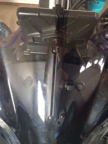

I just bought a 6" ram arm and installed this past weekend. A downside to this is I cannot use my wind shield bag. photo.JPGphoto 2.JPGphoto 1.JPG

I just bought a 6" ram arm and installed this past weekend. A downside to this is I cannot use my wind shield bag.View attachment 101688View attachment 101689View attachment 101690
Thanks for the pics. That's what I'm going for. Do you like that location? I'm hoping I can still use my windshield bag.

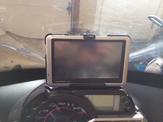

I like the location, in my line of sight. With the Nuvi, the top edge is touching the windshield, so I doubt I can use my windshield bag.

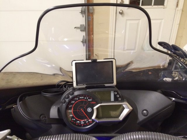

I'm the one, who had posted the mod referred to in the link above. I've been running this set-up on two sleds for the past few seasons now, with no complaints. As you can see, this also allows the use of a windshield bag.
