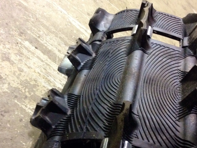

Rear suspension/track: I don't know if this was from the factory or the dealer, but my track is on extremely tight. To the point where the rear wheels are bubbling the track out. See pics - looks as if the dealer tightened up more than usual...I thought this set up was designed to run loose?

Track will stretch and take a set. You may end up tightening it eventually. Those bulges are one more reason to justify a 4th wheel kit. The extra wheels will lessen that bulging and pressure on the two inside wheels considerably.
