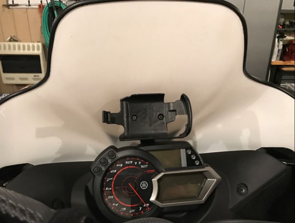

I mounted mine the same location.
Hope I love it as much on trail as I do in the garage.
I have had bar /tank area mounted maps before and I had a hard time to glance at it while moving on the trail. Hoping this is more like glancing at the gauges which my eyes can still do.

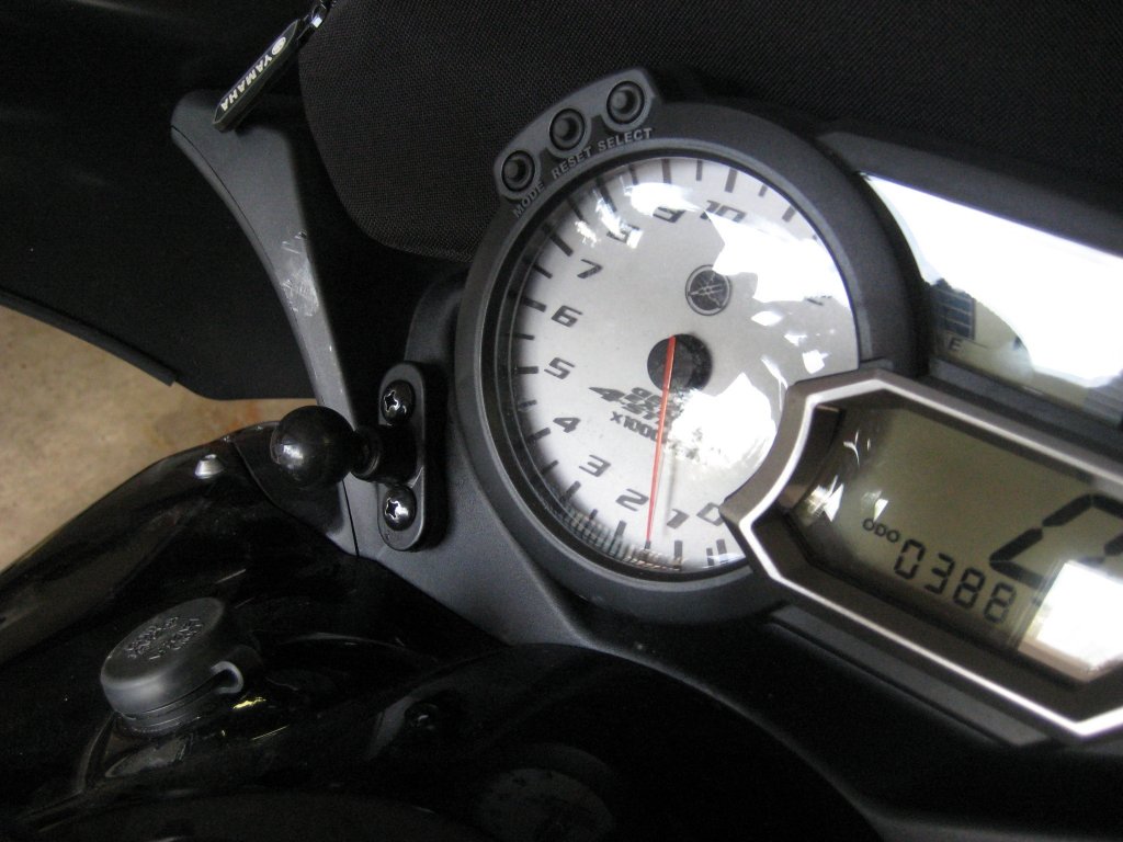

I went the easy way and bought an offset ball and used a screw to the right of the gauges.
Good job.
Good job.

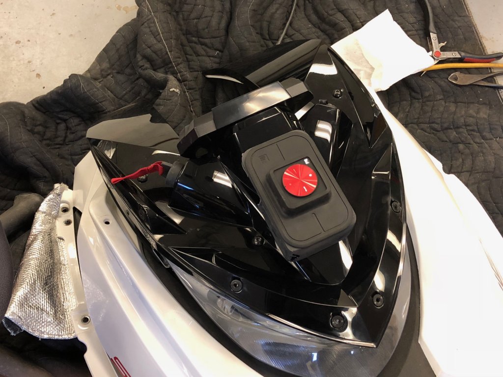

I just mounted Nuvi 50 using the handlebar ram mount on the dash. Stiffened it with some nice big fender washers on the underside. Ran a dedicated line from battery into the google bag.

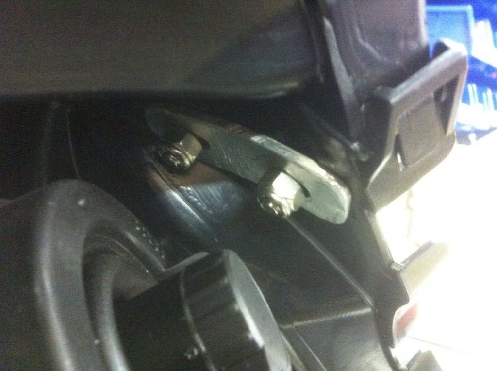

Here is how I mounted mine using a RAM mount. In this case I used the handle bar mount with an aluminum backing plate on the backside of the instrument housing. I've done this Mod on 3 different sleds.
