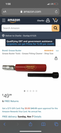

rippintheyammi
- Oct 29, 2021
- 10
- 41
- 2010 Yamaha Nytro RTX SE
I'm going to order one of these up and give it a go. I'll most likely have to attach a hose to it since it is pretty tight in there. If it avoids me pulling the skid, i'll be a happy man.This is what I use on my skid steer zerks that stop taking grease
