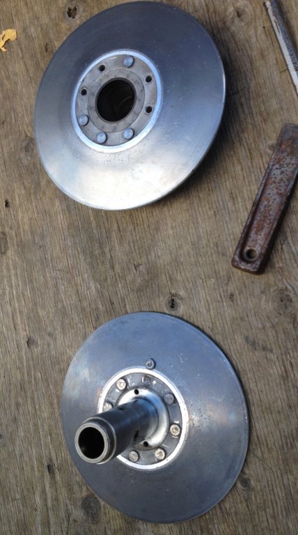

A friend of mine had rivets pop of his secondary clutch on his 2010 grizzly 700, and cause all kinds of damage, then I went to clean up my clutches on my 2009 700 griz and found 3 rivet heads flying around in mine for a couple thousand kilometres, wife's 09 seems ok though, I couldn't find a machinist that does the same press rivets so I just used 1/4 pop rivets and see how it holds up...other then millions of little pits I had no damage so I put back together, sounds like lots of people had problems with this secondary clutch fail from 2009 to 2010.

Never heard of that before. There should not be any rivets in the secondary or primary that are used for clutching.

take any pic's for us to see? interested in seeing this.

I did take pics of this,when I get home in a week I'll put some up!take any pic's for us to see? interested in seeing this.
